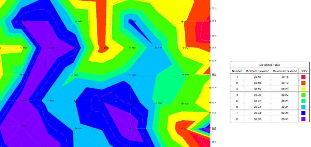

Here's and option for you, in this particular case I was doing a camber survey on the newly constructed second floor of in a warehouse building. So I did a surface analyses with a range. here I'm only playing with 0.18' of elevation change.

If you have access to a large scale color plotter or will be presenting it on screen, @rl_jackson 's color 'heat map' is great. This past summer I had to do an analysis of a problematic milled surface and produced heat maps with 1/4" elevation differences (0.0208').

@AllenJessupYes, that approach did seem the most legitimate for what I was going for. Heat maps work great, but most of my clients absolutely hate color. Especially red.....red means bad ju-ju. So we don't do colors often, unless it's a cartoon for a proposal or it's needed for illustration purposes. I made a surface with 0.2'-1' contour levels and I think that'll suit the client fine. It gave me at least a couple of contours, which is better than the none I had before. I typically don't like to mix interval levels, but on this occasion I reckon it was merited. Thank you for your input.
