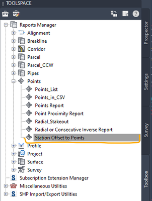

ecfernandez
in reply to: mughaladeel9
You can create the points wherever you need them and then use the "Station Offset to Points" report to get the information
