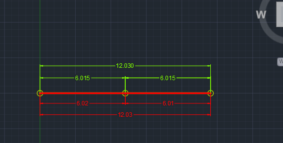

Image-1Image-1
You can get rounded dimensions by by customizing the precision in your DIM STYLE and you can get the area from a FIELD. You can even specify two decimal precision when getting that field (refer to image-1). And you don't need to redraw.
Using YOUR rounded coordinates, these are YOUR points. The points, the one you referred to as 'top coordinates' were inserted then connected with a line (green lines are underneath the red lines). There are two sets of dim styles: green dims measuring the green lines (3 decimal dim style) and red dims for red lines (2 decimal dim style).
Image-2Image-2
You can see the GREEN dims are accurate: 6.015+6.015=12.030 (refer to image-2). The RED dims, however, look flakey. Although 6.02+6.01=12.03 is correct, the adjacent properties boundaries are not symmetrical. The two properties can't be divided perfectly in half with only 2 decimals, you need 3. To get two identical lengths after rounding the coordinates, you have to modify one or both footprints, and that's too much work.
You could also choose to use unequal prop boundaries but why would you do that? What rational explanation would justify moving from already equal to modified unequal? And just to be ultra clear, the red dims are unequal because you chose to use Rounded Coordinates.
