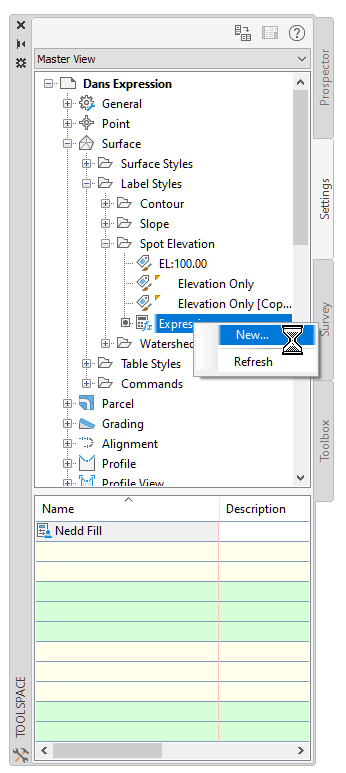

The expression calculations are not fully automatic.
Start in TOOLSPACE >>
Settings Tab >> Position to the proper branch
Right-click Expressions and select New...
The New Expression form will be blank.
Fill in the Name and Description field manually.
(The Name cannot be changed so avoid spelling errors.)
If is best to choose properties and functions using the buttons and drop down lists.
Click OK to save.
Note: Click [Help] for some well written information.)
