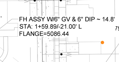

Is there a way to add a return to text in a part description label?
Example; part description now reads
FH ASSY W/6" GV & 6" DIP ~ 15.8'
When I place my label in plan sheets, I have Description as my top component which make this longer than I would like. I know I can set a Dragged State Maximum Text Width, and this works but I also have Station and Surface Reference text elevation that follows in the label. I would rather simply have the description break into two lines if possible.
Desired label:
FH ASSY W/6" GV
& 6" DIP ~ 15.8'

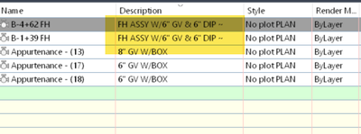

You use this in your part description in the toolspace?
Example FH ASSY W/6" GV & 6" DIP ~ 15.8'
would become FH ASSY W/6" \P \X GV & 6" DIP ~ 15.8'
This is what I am trying to stack. The first line of text
Message 6 of 12
rl_jackson
You example would read
FH ASSY W/6" GV\P& 6" DIP ~ 15.8' or FH ASSY W/6" GV\X& 6" DIP ~ 15.8'
I have used this for cogo point labels, not sure about pipe labels but it's worth a try.
Rick Jackson
Survey CAD Technician VI
Message 7 of 12
RobertEVs
Yes, that works perfectly. This is what I was after without the dragged state max width setting. Thank you Sir!!

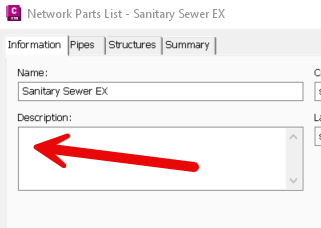

have you tried that in part list description?
Joe Bouza
Message 10 of 12
RobertEVs
Are you referring to the Parts List Information Tab Description?
I used it in my Toolspace Description for an appurtenance part. Works great.
