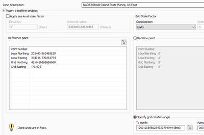

Lots of Geolocation posts on here but I can't find anything that addresses my problem.  Whenever we survey a new site we tie into state plane coordinates.  When I bring the points into the drawing the map shows up as it should but it is always offset around 4' north from our points.  We are using C3D 2016. Our settings in our GNSS equipment and the C3D drawing are the same (RI83F).  I have asked our C3D reseller and our GNSS provider and neither could help.  I have attached a drawing of a site so you can see what I'm talking about.  Check out the pool and edge of pavement and you'll see it clearly.  I have a feeling it's something small but it's driving us crazy.  Thanks in advance for any help!

sboon
If you know what the adjustment is you can make that permanent for all of your drawings by setting it in your template.
When you set a coordinate system Autodesk Map gets involved, and it changes the Transformation settings in your drawing.  In your case they should look like this.
Copy the local values to the grid values, change the rotation to zero, and make sure that the Apply button is turned on.  Now the Bing image should come in at the same location that it is currently.
Next step is the adjustment.
Play with the grid values until the image fits correctly.  Open your template drawing, edit the numbers to match and save that file.  From now on all new survey plans should match Bing.

ronald.tubman

sboon
That depends on how and where you import the field data.
In Civil3d the North and East values you see in the drawing are assumed to be GROUND values.  If you import points from a text file and your Import/Export format uses the default headings then the software assumes that file is also GROUND coordinates.  Points in the drawing will match points in the file.
The coordinate display in Civil3d can also show you the calculated GRID values for points.  Here's an example of a drawing that has a scale factor and transformation applied.  Notice how the GRID values are very different from the GROUND coordinates.
If you import or export GRID data (and the Apply Transformation Settings button is turned on) then the transformation and scale factor will be applied as the data moves in or out of your drawing.  If I was to export points from this file using a format that specifies GRID north and east then the text file would show those GRID values in it.
The other factor to consider would be if you use a survey database.  Coordinates in there are generally assumed to be GRID.  If you were to import a point file there and then move the data into your drawing with Transformation turned on then the GROUND points would be shifted.  There are ways to get around this, but it depends on your workflow.
