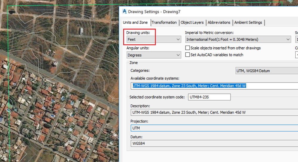

I'm using civil 3D 2017, and i'm trying to open the aerial map in a Infraworks exported file, but the image doesnt show up. I swear i tried every single solution that i found here, but none of them worked.
What i'm doing is:
On Infraworks: Generate a model > Find a plce > Export imx file > Choose an area
On Civil 3D: Insert tab > On infraworks icon > Open infrawork model. Then, when the surface is there i try to turn the aerial map but when i change nothing happens. The ''BING'' logo is showing, but that's the only thing that display.
Solutions that i already tried: Reinstall all autodesk apps
- Sign out and in on my civil 3d account on civil 3D software
- Sign out and in on my accounts on browser related to autodesk
- Cleaned my internet info
- Reinstall only A360
- Turn on the hardware acceleration
- Install the Hotfix
I'm attaching a screenshot.

what coordinate system is assigned to the drawing and more importantly, is the drawing in a correct location relative to the coordinate system?

Hi warren, thanks for replying.
About the coordinates, i dont know much about so what i do (and it used to work a few months ago) is on the screenshot that i'm attaching, thats the only thing related to coordinates that i use and know

Your coordinate system is fine - as long as you are somewhere near Brasilia. My BING maps isn't showing anything either right there.

Got it - there are other objects WAY outside the bounds of your coordinate system in the drawing (ZOOM EXTENTS to see them). If you erase (erase ALL, remove your surface) them and save, then reopen your drawing the maps work fine.

The UTM84-23S Coordinate System is Metric.
I looked at your Metric Units Drawing, which does NOT show Bing Live Maps no matter how far I zoom out, and Warren's Imperial (Feet) Drawing which shows Bing Image, and I had to conclude that your data is suspect.
