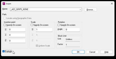

Occasionally no amount of cleaning will help, and I find I have to recreate the drawing.  In that case, create a new drawing, insert the existing drawing into the blank drawing.  Make sure you check Explode.  I like the classic insert command for this.
To recreate the layout tabs, Right click on an existing tab (probably layout 1), and select From Template....
Change the files of type to .dwg, and select your defective drawing.  The insert Layout(s) window will pop up, select the layouts you want to import to the new drawing.
Hope this helps, thanks.
