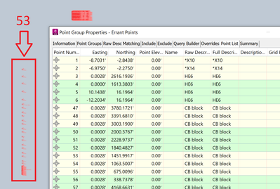

@PointdumpThis script is almost perfect, but it inserts some garbage points as well? As you can see below there are 613 points exported when there should only be 560. the rest of the points inserted southwest of the main drawing in two columns
Message 34 of 51
carl3ZPF6
@PointdumpAll of the garbage points seem to have negative easting
Message 35 of 51

Yes but I cannot know that that will always be the case these block arrays can be massive
Message 38 of 51
carl3ZPF6
@Pointdump  For example in this file I just copied the base pattern, and it is big enough that the actual points are now indistinguishable from the garbage points.

Pointdump
Carl,
I discovered something. If you WBLOCK out the 560 blocks to a new drawing, then the Dynamo graph works as expected. No garbage points.
Dave
