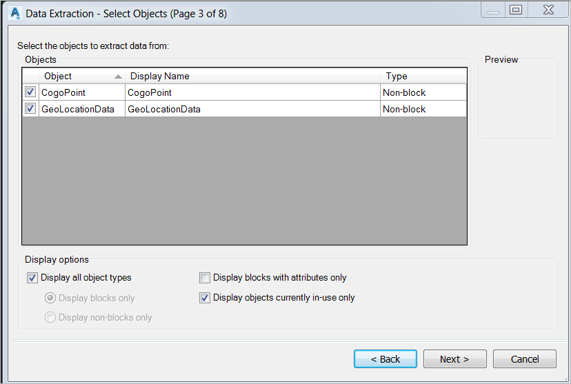

FYI, the procedure DATAEXTRACT doesn't work on cogo points. Even though that command lets you run through the entire wizard up until and including FINISH, it won't produce a file with data. It's a total fake-out.
1-The DATAEXTRACT wizard lets you select cogo points so you can extract 'data.'1-The DATAEXTRACT wizard lets you select cogo points so you can extract 'data.'
2-Cogo points have lots of data. Notice the slider on the right, more data than you can see.2-Cogo points have lots of data. Notice the slider on the right, more data than you can see.
3-The end result. What a scam! What a fake-out!3-The end result. What a scam! What a fake-out!
Chicagolooper
