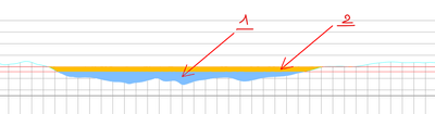

Hi, I have created material tables that give the area on different profiles on Civil 3d with 'Create Material Volume Table':
This is exactly what I wanted but now I need to export it in xls, csv... but no way!
The command tableexport says it is not a table, and the The Civil Table Export add-in is not available anymore on the  autodesk site. The volume report in xml doesn't show the same areas:
I am turning crazy, can someone help me? thank you!

Hi Camilo, thank you very much for you quick reply.
Unfortunately as I said in my previous message this table doesn't show the material areas of my profiles...
What I need is the material table, not the volume table. Or maybe did I do something wrong?
I need these 2 areas:
They both appear in the material table, not in the volume report.

Hi @marie-laurence.pollet, I'm sorry I misunderstood your post. You are right, the report won't show you the area of those hatch you have on the profile. That report shows the estimated sectional volume.
I have used those profile hatches just as a visual representation of the cut and fill locations along my main alignment. I have never used them to estimate material quantities.
I am curious about your request. Could you please explain what you are trying to do?
Hi Jeewana,
Actually 'profile' is a word my client understands, as sample line is an autocad term that won't mean anything to him (french client).
Hello Camilo,
This request is actually a strange request from a french state client... He wants to determine the 'wetted sections' of the channel on 40 profiles, under 2 different sea levels (-0.85 m CM and 0 m CM). I think this is a way for him to evaluate the available volume of possible evacuation of the water to the sea, by multiplying the area of each profile by the interprofile distance (old method indeed).
