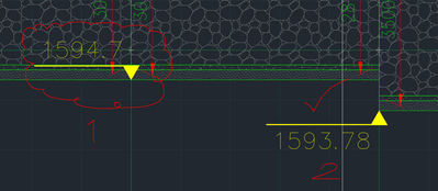

I found a CAD lsp from Lee Mac, which helps me a lot. My only problem is I always mirror the annotation, is there any code how to change it into number 2 option? If I follow the number 1 default settings, it can not read. Please help..😭

Could you create a dynamic block with a flip and attribute text that reads the block position? I used the marker from the lisp to create the block.

You could ask Lee, the best way is probably through the website lee-mac.com .

wow! this one is also amazing sir, thanks!
