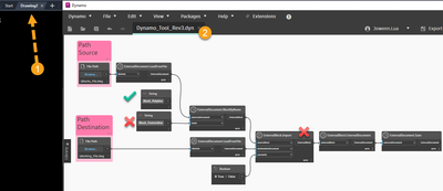

While building a Dynamo tool, I encountered an issue where COGO points become bugged after using Dynamo to import a block from an external file. This issue only occurs when the imported block contains feature lines. I wonder if this is a bug in the "Block.Import" node. I have attached simplified .dwg and .dyn files.

Thank you for reporting. It looks like a bug in my initial test. I tried using Block.Import and ExternalBlock.Import and saw Cogo points gets deleted or corrupted. Please post this issue in Dynamo Forum.
