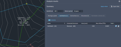

I'll assume this is a Me problem, not a software problem, but I'm attempting to use the drainage analysis tools in 2026, and I'm getting runoff results that are way too small, by a factor of 30. I have a simple drainage network of 7 inlets, with contributing areas for each inlet ranging from 10,000 sq ft to 44,000 sq ft. The catchments are set to the Rational Method, and I'm using NOAA IDF curves. Time of Concentration is manually set at 5 minutes, as the small areas gives something lower than that.
For a rational method runoff of Q=CIA, if I have a C of 0.9, intensity for a given 5 minute storm of 1 inch, and an area of 1 acre, shouldn't my runoff be 0.9 cfs? Instead I'm getting runoff of around 0.03.
I'd like to think its something I'm doing wrong, but I don't see how to check.

That's what I'm trying to figure out, is what is going on with the inputs. Running the "Time Area" method, (which looks like SCS but I'm not sure how its different) gives results that seem reasonable. If I run the "Analyze Gravity Network," which looks like it solely analyzes using Rational Method, it gives results that are consistent with my inputs. I can follow the time of concentration calcs, and it the math for runoff checks out.
Setting the Catchments to Rational Method and re-running Drainage Analysis is where it falls apart though. I figured out what it's doing - using a storm duration of an hour - but I still can't figure out WHY.
Here are screenshots of my results - Drainage Analysis "Time Area" method (good), Analyze Gravity Network (good), Drainage Analysis Rational Method (no good), and I've attached the Excel file exported from Drainage Analysis.

I had run into this on a recent project and reported it to the dev team. It looks like it might be a metric conversion issue but that's the best I can help with on what's going on.

Seems like it .. 35.3 conversion factor. Also that field should read peak runoff for a catchment result tab.. not inflow

We’ve identified an issue where imperial IDF intensity values were not being converted correctly for the Rational Method calculations. The underlying issue has been addressed and is currently going through our normal release process. While we can’t share release timing or version details yet, we’ll update this thread once the fix is part of a publicly available release.
In the meantime, as a workaround, you can convert imperial IDF intensities from inches per hour to millimeters per hour and enter those metric values as if they are the inches per hour values.
