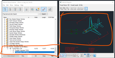

Hi @weasonWRRFJ, I hope you're doing fine. Look for your aircraft and edit a copy (assign the name of your preference). Click Ok. Then, look for the tug and select the vehicle, left-click, hold and drag it to the brand new aircraft you just created, you should get something like this:
Once you get it, you might start editing the vehicle's parts if needed so you make sure your vehicle will represent in a good way the reality.

weasonWRRFJ
Thank you !  It helped to confirm I had it arranged correctly.
