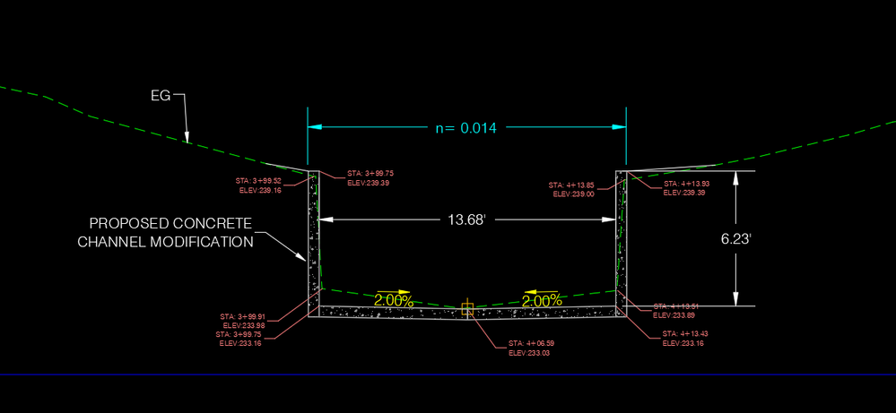

fcernst
I like to use the Generic Pavement Structure subassembly to build things.. it has a lot of capability with coding, depth and targeting.. you could target the embankment in your case..
My current channel modification project:
