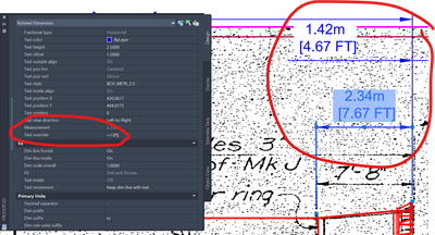

Hi, When I use background mask on my dimension text and stack my primary units above the dimension line and alternate units below the dimension line (using \X between the two), the mask hides the dimension line. I know there must be a setting to bring the dimension line forward because I've seen it done in other CAD drawings. Does anyone know the setting for this? It doesn't seem to have anything to do with bring to front or back order because the dimension and the text are all one object and you can't separate one from the other in order to bring the dimension line forward. Thanks for your help, Darren

Thanks Rick, I tried typing in \P between the primary and alternate units while editing the dimension text and it didn't automatically update it like when I type \X. It just added the text and in the properties Text Override setting, it shows two backslashes \\P. I then tried editing the Text Override setting by removing one of the backslashes and it just stacks the text above the dimension line instead of splitting showing the primary units on top and alternate units below. A couple screenshots below. Thanks!

Oh interesting. I figured it out. So you use \X and it separates the primary units above the dimension and the alternate below with the mask overtop of the dimension. But then you have to select the dimension and hover over the grip and then a menu comes up automatically. You then select Reset Text Position and it separates the mask and allows you to see the dimension. Good grief Autodesk. Why make this so difficult. Thanks everyone for your help. Darren
