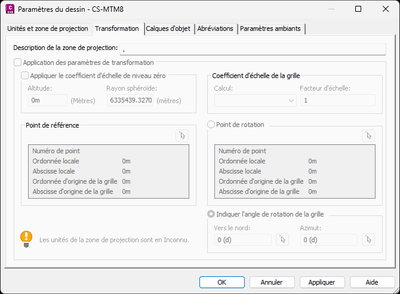

And this makes me think of another thing.
In the drawing parameters the Transformation tab, what is it's use for ?
Those parameters are only used when importing something ?
If so what (Cogo, etc) ?
Frank Freitas
CAE/CAD/BIM Coordinator & Support Specialist
LinkedIn
Message 16 of 24
cyberflow
Ok so the transform tab is really only for import point :
https://www.youtube.com/watch?v=jJpNc3ZwtKE
Frank Freitas
LinkedIn

"the transform tab is really only for import point"
No, it transforms linework too. The Transformation Tab usually breaks Bing Live Maps, but it works well for most everything else.
For the Transformation Tab, do you have an example of where it applies in linework ?
