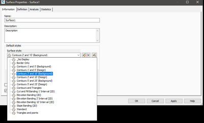

AllenJessup
Based on your screenshot. It looks like you have a Surface Style that only shows the Boundary. You'd need to set (or create) one that shows the contour interval you want.
Right click on the Surface in the Prospector tab and select Surface Properties. Set a Surface Style that shows contours.

JimJonesPELS
Thanks.
I actually I had to turn the lights on for the layers.  I can now see the contours in the drawing.

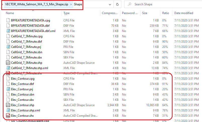

ChicagoLooper
Source:
The National Map (TNM)
Instead of DEM, download shapefile.  Compared to raster data such as DEM, shapefile is vector and much easier to work with when compared to raster data. Shapefile data also includes a projection file (prj) so there's no guessing what the native coordinate system is being used by the shapefile. Image-1.
Image-1Image-1
If you can click a mouse, you can search for and download free elevation data in shapefile format. The download is immediate, no need to set up an account and no need to disclose you email address. Image-2.
Image-2Image-2
The search result and the download link. Image-3.
Image-3Image-3
The TINN surface has been built. Typically the contours from a shapefile are smooth and fluid, DEM contours, on the other hand, tend to be jagged.  Image-4.
Image-4Image-4
