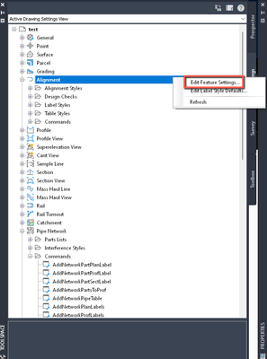

Doesn anyone know wher I can set default alignment style and label set for Alignment from Network ?
There is CreateAlignFromNetwork under Pipe Network Commands but I can`t find there default style for alignment. There are only default style for pipes and structures.
376 Views
v-silvestre
I just tested this and it looks like it defaults back to what is set under the Settings Tab > Alignment > Edit Feature Settings > Default Styles:
cwr-pae
Most of these settings can saved/set be turning on "Save Command Changes to Settings" and creating the object in your template then deleting it and saving the template. You can set "Save Chages to Settings" for each category (alignment, etc.) to globally for the file. Don't forget to reset any counters before saving the template file.
