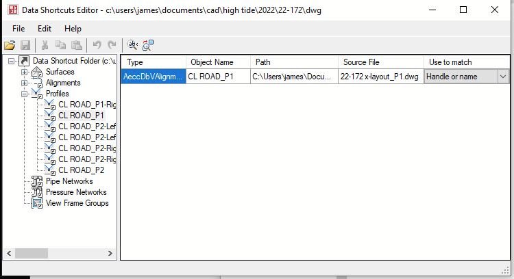

I have a data shortcut that was created quite a while ago, but it no longer appears in the collection of shortcuts in Data Shortcuts area in the toolspace:
Also, everything appears fine in the Data Shorctus editor:
Anyone ever encounter this before? I haven't found anything on the forums in a couple of searches.

No, as you can see in the Data Shortcuts Manager, the problem is only reiterated, and there doesn't appear to be a shortcut in the list on the right to even connect the object to:
But the shortcut has already been created. The shortcut is in the Profiles folder, it isn't empty, has all the code you'd expect opening it an editor, and the Data Shortcuts Editor shows is existing, and finally if I try to  recreate it, it is grayed out as though it is already created. Yet it doesn't show up on the collection.
