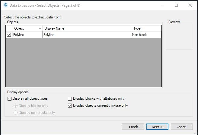

here is snip of what my dataextraction looks like, there is no coords (x,y,z) that i can pick to extract? I get length, no problem. not sure what i am doing wrong, i had them as regular polylines and as 3d polys, no Z value
regarding the 'PS" yep, i have all ranges from slope on separate layers and i have isolated them to DE them into and xls file.
again thanks for the help

Neilw_05
Go back through your object properties fields in the DE settings. As long as you are only extracting polylines you will see a field for elevation. If you have mixed polys, lines, 3D polys, etc., that option my not be available since it doesn't apply to the other objects. I don't have time to run any tests but it seems to me the Elevation field should still show up, it just won't have any values for objects where it doesn't apply. I could be wrong, that is why I suggest limiting the object selection to 2D polys.

Message 9 of 14
this is odd, when i explode the polylines, and DE i get x,y & z values, but when go back and join or pedit join them back together, the DE, i lose x,y,z values....
