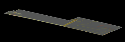

Hi All,
I have a situation where I need to balance Cut/Fill below a certain elevation (10.90m) - the majority of design levels for the site sit higher than 10.90m and the existing surface sits lower than 10.90m.
To do this currently I have extracted user contour of 10.90m from my design surface, created a 2 separate surfaces where the area inside the 10.90m contour is a flat pad at 10.90m and the other surface is simply the design surface with the area which exceeds 10.90m in height hidden - I've then pasted these together to create a surface that I can use for volume comparison to the existing surface.
Does anyone know of an option that would skip this step? i.e. a bunded surface on volume dashboard or similar that only analyses the surface below a specific RL? Does something like that exist? i.e. I could just do a normal comparison surface between EXIST and DESIGN but only tell it to analyze under the specific RL of 10.90m?
Thanks very much in advance for any help!

Sorry I probably didn't explain it as well as I would have liked with just words. I don't think its that simple unfortunately (please let me know if I am wrong though)
The model below is the Finished Surface Model (you can see steps in building pads etc)
Given that there are portions of the design that sit under the RL 10.90m I still want those included in the volumes as well so the surface I have created to check volumes under the specific RL of 10.90m looks as below - you can see the large flat pad at 10.90m but still a good portion of the design sits under 10.90m with varying levels
Profile view below to try and demonstrate a little clearer as well
