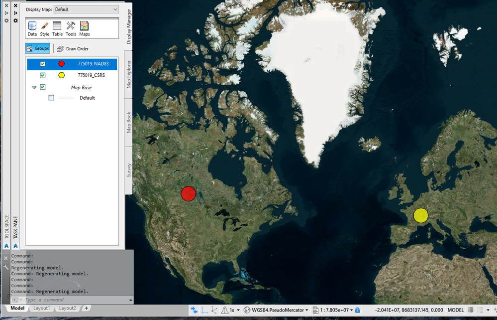

Thanks for posting about this. I'm questioning my assumptions about what is shifting. Using the suggestion from @ChicagoLooper , I exported Control Point #775019(Nipawin, Saskatchewan) as Decimal Lats and Longs(to the maximum 17 decimal places). In QGIS I saved that point in 2 Projections:
EPSG:2957
NAD83(CSRS) / UTM zone 13N
EPSG:26913
NAD83 / UTM zone 13N
Open 2 empty Metric Drawings, assigning one of the above Coordinate Systems to each drawing. Drag-n-Drop both of the attached shapefiles into each drawing. In the CSRS drawing you get two points 31 Meters apart. In the NAD83 drawing both points land in the same spot.

ChicagoLooper
Hi @Pointdump ,
Thanks for following along. We are both cynical skeptics.
What are the Lat/Longs of the red and yellow points the the C3D drawing using CSRS.UTM-13N?
In the C3D drawing using UTM83-13, both the red and yellow points have the same Lat/Long AND the same x,y coordinates (cartesian). This is how it should be, correct?
Just curious, if you created a third C3D drawing using the coordinate system WGS84.Pseudo Mercator (EPSG 3857) with spherical geoid, then drag-n-drop the QGIS shapefiles, would the results be like image 1 (red & yellow apart) or image 2 (on top of one another)?

@ChicagoLooper,
"... using UTM83-13, both the red and yellow points have the same Lat/Long AND the same x,y coordinates (cartesian)."
That is EXACTLY the right question to ask, since Lats and Longs of same point on earth will be different for every Datum. Here is the workflow:
1. In C3D create a COGO Point in a UTM83-13 drawing:
N: 5906906.268
E: 566463.689
Z: 370.1993
2. Export Lat and Long to a text file and use that to create an LL84 Point in QGIS.
3. From QGIS, Export that point in 2 different Coordinate Systems:
EPSG:2957
EPSG:26913
4. Drag-n-Drop those 2 shapefiles into drawings each assigned one of those CS's.
OK, so it gets weirder. When I Drag-n-Drop those 2 shapefiles into a drawing assign EPSG:3857, one of 'em lands in Europe.

ChicagoLooper
@Pointdump wrote:
......... Drag-n-Drop those 2 shapefiles into drawings each assigned one of those CS's.
OK, so it gets weirder. When I Drag-n-Drop those 2 shapefiles into a drawing assign EPSG:3857, one of 'em lands in Europe.........
When you drag-n-drop the shapefile what is displayed under the Coordinate System column in the Data Connect Palette? Does it match the shapefile's prj file?

Pointdump
@ChicagoLooper,
Thanks. I forgot to check after the Drag-n-Drop. But it's back to 2 points 31 Meters apart.
