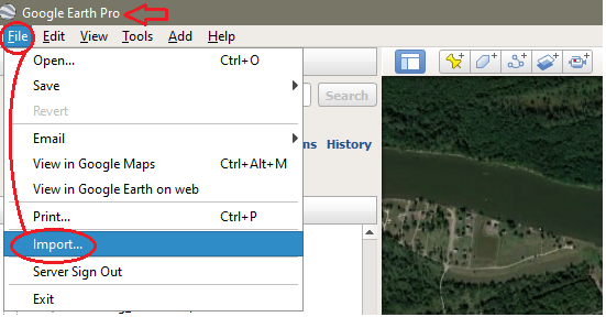

1. While in Google Earth Pro go to File=>Import

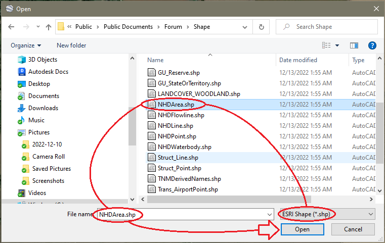

2. Change files of type to ESRI Shape (*.shp)=>Browse to then select your shapefile=>Open

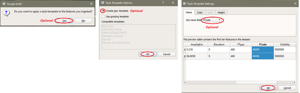

3.The next three (3) windows are optional.  If you choose to set up a 'Parcel Template' you may choose PIN for Set Name Field under the Name Tab (refer to image on far right). This example shows FCode instead of PIN.

4. If you choose to exercise this option, Name and Save your template in the default Google Earth Pro folder. The template will have '.kst' extension.

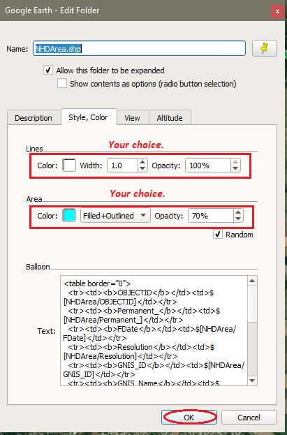

6. Right-click the shapefile's name to access the Linework Properties. You can control line color and line weight. You may choose to have fill (hatch) or not to have fill. You may choose the color and transparency of the fill.
.Image-6Image-6
