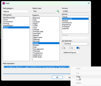

I currently have a nested block which shows "0.00" as elevation and after exploding it gets the actual elevation (like "123.45"). Due to several reasons this behavior is not very handy so I'd like to get rid of this block and start from scratch.
The requirements, however, are a bit nasty since it also has to work when opened in Vanilla AutoCAD (not just Civil 3D), hence COGO points are off. Also I prefer not to have a nested Block again.
So I thought this would be a simple task, yet I just can't get it done.
Here's what I have: A set of crossing lines (an "X" for the position) and a Text (for the elevation).
But how can I tell the attribute to contain the Z-Coordinate of the Block itself? Is this even possible?
The screenshot shows my current process, but this seems to be the wrong way. As soon as the block is inserted, the attribute shows the static text "InsertionPoint".
I could need some help here, maybe I misunderstood this concept.

You have the option to add an object position – or in this case elevation as we are just using the Z.  The field expression, when creating it will only let you select a different object.  But You can copy the field expression and paste that into another object, in this case we want to refer to the same object.  It won’t let you do this when you are creating the text.
But I can create a second piece of text, and refer to the first piece of text.  Looking at the Field dialog box, copy the field code at the bottom and paste this into the first piece of text. Now I have text labeling the elevation of itself.

The key is the far left column on the Field dialog, where you set the Field Name, Object, then press the green button at the top of the second column. This lets you pick and object on the screen. This will make a direct one-to-one connection between the field and the object from which it is pulling the property.

Are you placing the block at an elevation, and then want an attribute (with field) to display that value? The block could be as simple as just the attribute, but it needs something, an object, from which to gather that z value. Keeping with the theme of simplicity, a Point works well here. You can set Pdmode = 1 and you won't even see it, but the Field can still use it.

To capture the properties of the block reference in drawing inside the block definition we need to use the BlockPaceholder Feilds, the attached drawing has a block which is using the z property of the block insertion point as the default value for the attribute.
