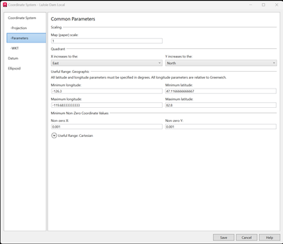

It was killing me so I spent some time and got it working. I learned a few things along the way. To calculate the parameters for an affine projection you need at least 3 tie points. My first attempt to Rube Golberg a 3rd point wasn't good and so I tried to play with some of the parameters that I shouldn't have. The A0,A1,A2,B0,B1,B2 parameters do all the work. Everything else should be the source EPSG:3157 parameters. My second calculation of a 3rd point was much better.

Incredible Dave! Thank you again. I'm going through this in baby steps as it's all new to me. I had to download and install the Transformation extension for the Toolbox. I then set my original drawing "Units and Zone" to "NAD83(CSRS) / UTM zone 10N". Then created the local coordinate system using the parameters you provided (see screenshots below). When I executed the "Coordinate System Transformation" command, it transformed it but not to the correct local coord system. Mon A is at E24761.332, N11072.594 instead of E10000, N25000. I haven't figured out how to add the British Columbia GSB grid shift per your recommendation so will try to figure that out as well. I would like to understand further how you came up with those affine matrix calcs in the Excel spreadsheet so will spend some time trying to reverse engineer them too. Once again, thanks for getting me on the correct path here.

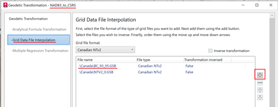

Edit your "NAD83_to_CSRS" Geodetic Transformation to add the BC Province GSB file. Civil 3D starts at the top of the list, so you can add other Provinces and it will choose the first one that applies to your area.
You'll put the BC GSB file here:
Program Data\Autodesk\Geospatial Coordinate Systems 14.10
(14.10 is C3D 2024)
You can get all the GSB files for Canada >>>Here<<<. (You'll need to create an account, but it's free.)
