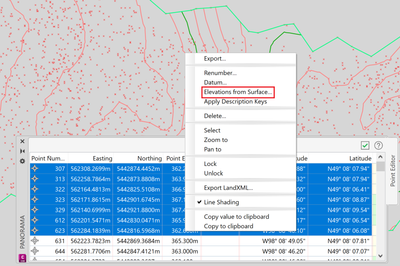

I've created a surface using feature lines, and now I need to make some points that I can export to a CSV file. The purpose of the CSV file is so the survey team can go and stake the location out for construction. I was hoping there was an easy way to create some points, like cogo points, that could read the elevation from the surface I finished instead of providing the elevation.
Does anyone know if there is a simple way to do that?

Hi Matthew,
How about Elevations From Surface?

This would also be useful.
