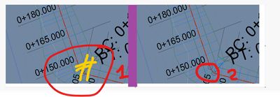

I want to create datum surface to calculate cut and fill material but datum link does not follow assembly bottom and it does not intersect with the existing surface.
Project file and section view screen shot are attached.

@alialp97 Your problem is that at some points in your corridor the links are overlapping. I am sending you images of the error and highlighting what is happening.
1. Problem with the overlapping of corridor links. This can be solved with the option to see image A.
2. Problem with the alignment radius. This can be solved by modifying the type of curve.
3. Problem with the absence of a curve. This can be solved by creating a curve in this PI.
Check the attachment and tell me if it is what you were looking for, I have added a radius of 8 meters and I have given the other a better tangent connection, tangent.

Thank you so much for your help. I saw my mistakes and It happened as I wanted.
