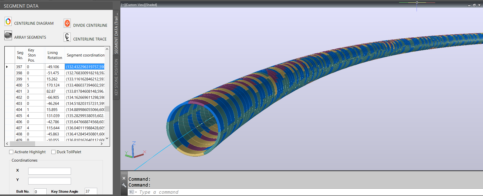

mehdi.Autodesk
Hi Gents,
you are right tim i get what she/he need to do in civil 3d
the calculation of corridors (alignment + profile) in civil 3d are plummet (vertical Z axis) base, on the other hand the positive point is aftre creation of corridor and extraction the 3d poly from that the next step can be:
1- Generating the 3D Solid By Sweep or 3D path array commands
2-Project 3d solid object in section View
some how as tim explained the last solution (if the elements array is really complicated) is programing which Autocad is really good foundation for this purpose , i tried it one for TBM precast lining.
