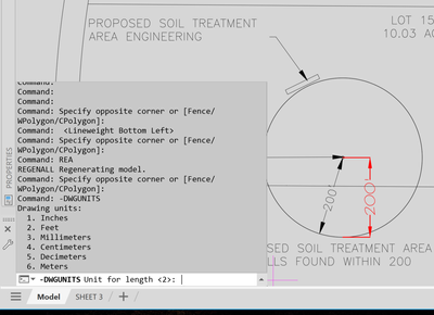

We need to convert 32 existing drawing files from architectural units to Decimal. Next in model space everything has to be scaled by 1/12 which leaves dimensions with large leaders. All dimension text needs to be converted to Decimal as well.
Not sure why the leaders remain large and do not scale down by 1/12 too.
Easiest/quickest way to replicate this conversion for all 32 CAD drawings?

"Easiest/quickest way" would be to XRef them into the drawing you're working on. Change Insertion Units to Arch and let C3D handle things automatically.

When you set Insertion Scale to Inches you're telling C3D that you are inserting, or Xreffing in, a drawing whose units are Architectural. C3D automatically scales things.
"how do you set the insertion units in a xref attach?"
Set command UNITS before you Xref in the arch drawing. And set it back to decimal if you then want to Xref in a decimal drawing.

Thank you. However, no matter what I used as insertion scale inches, feet, unitless the xref ARCH plan always came in 12x the size. I had to set Attach External Reference: Scale to 1/12 and uniform. Then my xref comes in at proper decimal scale.
Unless I was supposed to set the UNITS length type to Architectural in my Decimal Drawing then xref in using inches?

Your "ARCH.dwg" is not inch(architectural) units. It's feet units.

So do I want to set my ARCH dwgs to inches and in my decimal template set insertion units to feet?
Message 13 of 15
Pointdump
Robert,
Since both drawings are feet units, you don't have anything to scale. Set insertion units to unitless so that no scaling will happen.
