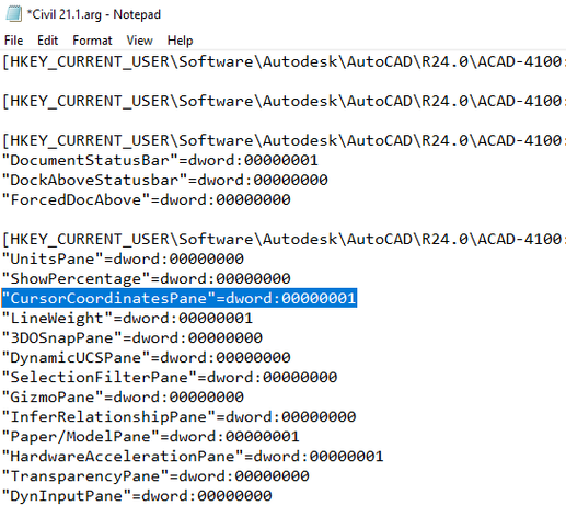

Oops. The only way I can find to change it is in the registry. What I did was export a profile in Options on the Profile tab. Then I went in and changed '"CursorCoordinatesPane"=dword:00000001' to '"CursorCoordinatesPane"=dword:00000000'. That closed the coordinate pane. Then I changed it back to '"CursorCoordinatesPane"=dword:00000001' and it opened. If you prefer you can change it directly in the registry.

JBerns
@Anonymous,
Here is some code that will "toggle" the Status Bar, Coords display in the registry.
;;; Toggle the Status Bar Coordinate Display value in the system registry
;;; for the current user and current profile
;;; J. Berns 2021-05-07
(defun C:RegCoordToggle	()
  ;; load Visual LISP
  (vl-load-com)
  ;; set registry path to status bar
  (setq	RegStatBar
	 (strcat
	   "HKEY_CURRENT_USER\\"        ;; current user
	   (vlax-user-product-key)      ;; user product key
	   "\\"                         ;; separator
	   (getvar "cprofile")          ;; current profile
	   "\\StatusBar\\Application"   ;; where Coords is managed
	 ) ;_strcat
  ) ;_setq
  ;; toggle the value
  (if (= 0 (vl-registry-read RegStatBar "CursorCoordinatesPane"))
    (progn
      (vl-registry-write RegStatBar "CursorCoordinatesPane" 1)	;; ON
      (princ "\nStatusBar Coords = On")
    ) ;_progn
    (progn
      (vl-registry-write RegStatBar "CursorCoordinatesPane" 0)	;; OFF
      (princ "\nStatusBar Coords = Off")
    ) ;_progn
  ) ;_if
  (princ)
However, you must exit and restart AutoCAD. Not much of a toggle I know, but I could not find any other way to "refresh" the status bar. Neither toggling the bar off/on (STATUSBAR) or toggling another option in the status bar menu would "refresh" the bar.
I would welcome feedback or suggestions to avoid the AutoCAD restart.
Regards,
Jerry
CAD Administrator
Using AutoCAD & Inventor 2025
Autodesk Certified Instructor
Autodesk Inventor 2020 Certified Professional
Autodesk AutoCAD 2017 Certified Professional
Message 11 of 11
JBerns
Correction to Line 14. It should be:
	   "\\Profiles\\"               ;; profiles
Unfortunately, still have not found a way to toggle the Status Bar item without an AutoCAD restart.
