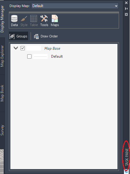

As Mr @Pointdump  has suggested, try MAPCONNECT.
Make sure the Map Task Pane is turned on and visible before connecting to yur image, otherwise the image may not load.
Image-1 (MAPCONNECT)Image-1 (MAPCONNECT)Image-2 (MAPWSPACE=>Enter ON on the command line)Image-2 (MAPWSPACE=>Enter ON on the command line)
