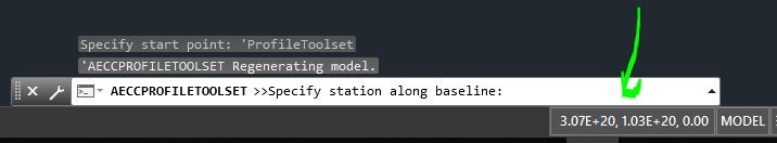

fcernst
When I try to use the new Profile Toolset command it creates two viewports zoomed out to E+20...
This is unusable..

Hi @fcernst,
That's odd. I've tried reproducing the behavior on my end and everything seems to be working fine. You can see a screencast of me trying to do this HERE. Not captured in the video is when I exit from the command, it zooms right back into the correct view.
I wonder if the issue is specific to your file. I'll attach the one that I used in the screencast so that we can rule that out as a possibility.

fcernst
Hi Mike-
Yes, the Profile Toolset zooms correctly in your drawing.
I still don't get a Transparent Command shortcut menu when I right-click in your drawing though while within a profile edit command..
