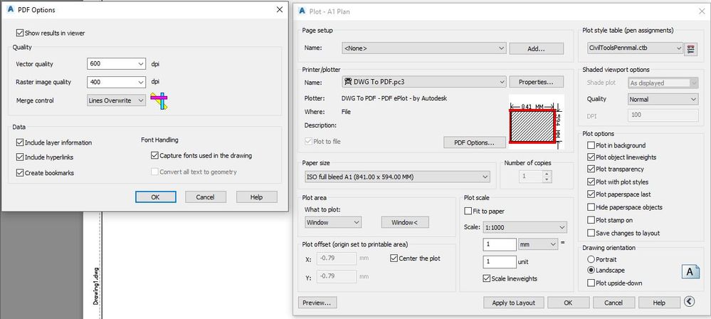

ere is my plotter settings and driver info

I do not use transparency, so I am not an expert, but I do not see anything wrong with your settings. You might check the visual style of your view ports because that can force raster, but it seems that it would also apply to line work as well.
