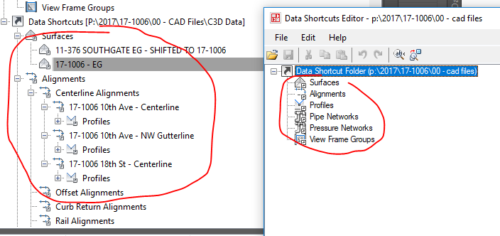

1. Data Shortcut Editor doesn't work properly, all data shortcuts created by C3D 2017 won't show up on the editor window. I have googled this issue, some other post has discussed about this (see https://forums.autodesk.com/t5/civil-3d-forum/data-shortcut-editor-is-blank/m-p/6733115/highlight/tr...), but have not found anything officially from Autodesk.

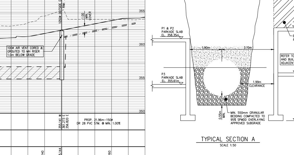

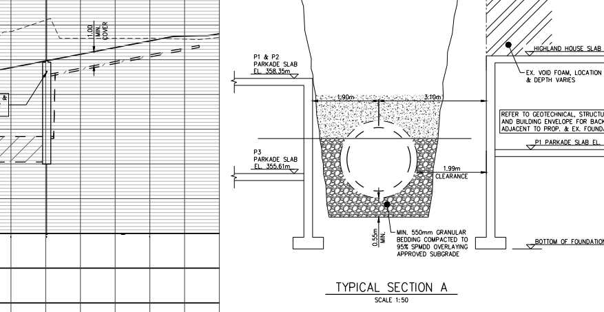

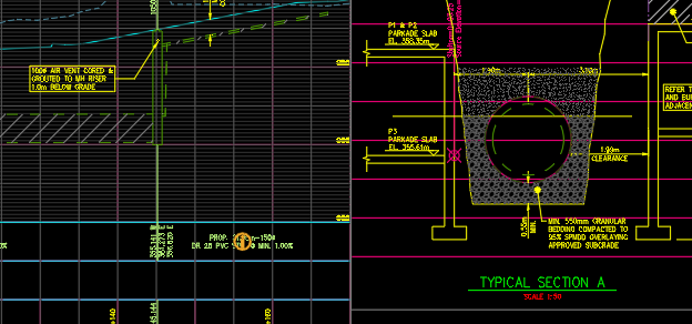

2. when we publish the drawings from the sheetset (we are not using background publish), pipe crossings on the profile view are not plotted. when I watch the process, i can see the plotting process starts before the pipe crossing show up on the screen (the pipe profile view is fine, just the crossing view not fully loaded). please the images attached below.
above is the screenshot of the pdf plotted manually by using plot command and dwg to pdf.pc3 driver cad2.PNG
above is the screenshot of the pdf published from the sheet set, as shown on the image, the pipe crossing on detail A is gone.

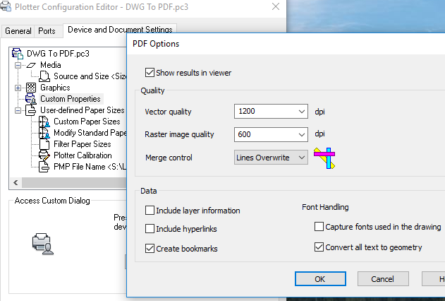

3. the pdf file doesn't automatically open in the viewer after the sheetset publish, but it does open automatically when plot manually (using dwg to pdf.pc3). we have "Show results in viewer" and "open in viewer when done" both selected.

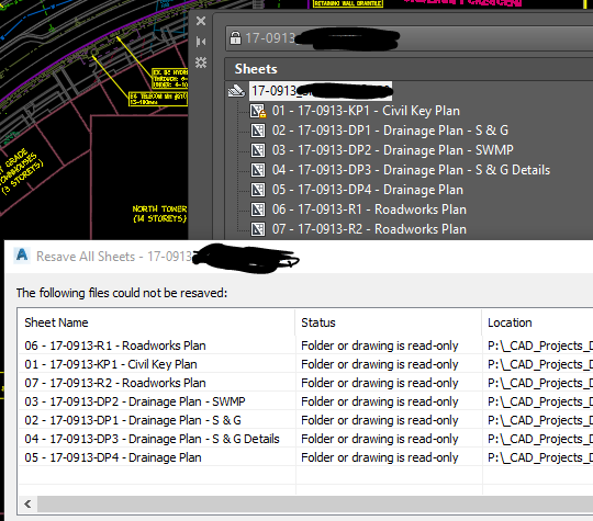

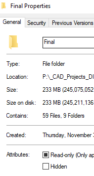

4. when trying to resave all the drawings from the sheetset manager, got an error message saying all drawings are read only.

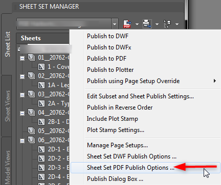

3- Make sure you check the Sheet Set PDF Publish settings (3a and 3b) if you haven't already. I'm pretty sure those will override others when printing from the SSM

4- Your Sheet Set has a lock icon in the top pull-down. It might be because you were in the process of resaving when you took the screenshot. If it's locked before you try to resave, than someone might have files open and that prevent you from resaving. If that is the case, you'll have to get everyone to save and exit before resaving all. If no one else is in the files, you shoul check the folder directory for any "stuck" .dwl and dwl2 lock files. We occasionally have issues when AutoCAD crashes, lock files aren't released even though no on has the file open. Deleting both the .dwl and .dwl2 has worked for me.

2. We typically set "DWG to PDF.PC3" as our default plot device, when we need to plot the drawings from the sheetset, we just right click on the sheetset, and then select publish to pdf (as shown on the image attached below)
3. as shown on the images in my original post, we have already set the pdf to be opened after plotting on the PC3 and Sheetset publish setting
4. the sheetset lock appeared on the image was caused by the re-save process.

1 - I misunderstood your issue with the editor. In the data shortcuts editor, have you tried to path to the "\c3d data" folder in the first image? Is that where the "_Shortcuts" folder resides? If you haven't tried opening different parent/sub directories in the editor, that would be my suggestion.

1. Apparently the solution posted by @deemanning in https://forums.autodesk.com/t5/civil-3d-forum/data-shortcut-editor-is-blank/m-p/6735931#M324230 resolved the issue, but since that EXE file is not provided directly from Autodesk, I can't roll that out to all users.
2. the issue has been resolved by simply audit the pipe network source drawing.

1. the folder setting is correct, and i have tried both, none of them works.

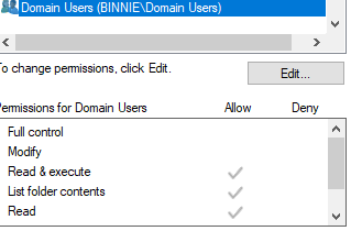

4. when the resave fails, it keep saying the folder or file is read only, I checked folder property, it does say "Read Only", I think that could be a user permission issue. however, C3D 2015 doesn't have this issue with the same folder security settings.

1. a new "ShortcutEditor.exe" received from Autodesk, the issue has been resolved.
