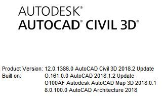

DBaker246
JN,
Interesting that you asked about updates.  I just updated the program just before I saw your post.  Here are the current specs:
Now that I have updated I will see if this problems still persists unless you have other ideas to solve problem.
