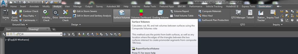

calculte cut and fill in civil3d
I find it difficult when you have alot of roads to calculte cut and fill volume in civil 2017 it make me do volume surface firstly then calculate cut and fill this take alot of time when you have many roads but in civil 2012 it is easy to calculate it is not need to create volume surface
if there is command to use civil 2012 calcualte cut and fill stayle in civil 2017 .

Jeew-m
Dear Friend,
Can you explain this bit more. As I see both images show same thing. If you click top left button of 2012 image you will get same window as in 2017.So at 2012 also you will make a volume surface.  The method is almost same.

h.malgarezi
To bring back the old report volumes table like in Civil 2012, just type the command REPORTSURFACEVOLUME
Message 10 of 11
thanks you solution is too right
Message 11 of 11
neilyj666
You can also modify the ribbon to add this command back where it belongs...!!!!
