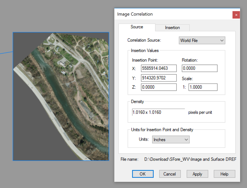

I don't quite understand this and when to use this setting. My units inside my template is set to Feet, not US Survey Feet. As a test, I changed my 'Units' to US Survey Feet then inserted a USGS Quad. This setting caused my image correlation units to go to inches and of course the USGS image did not come in correctly and was scaled huge. See pic.

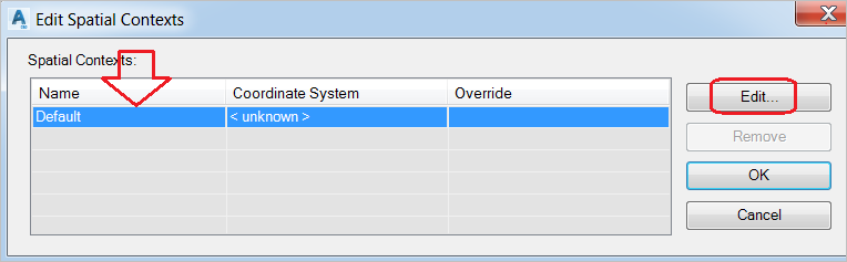

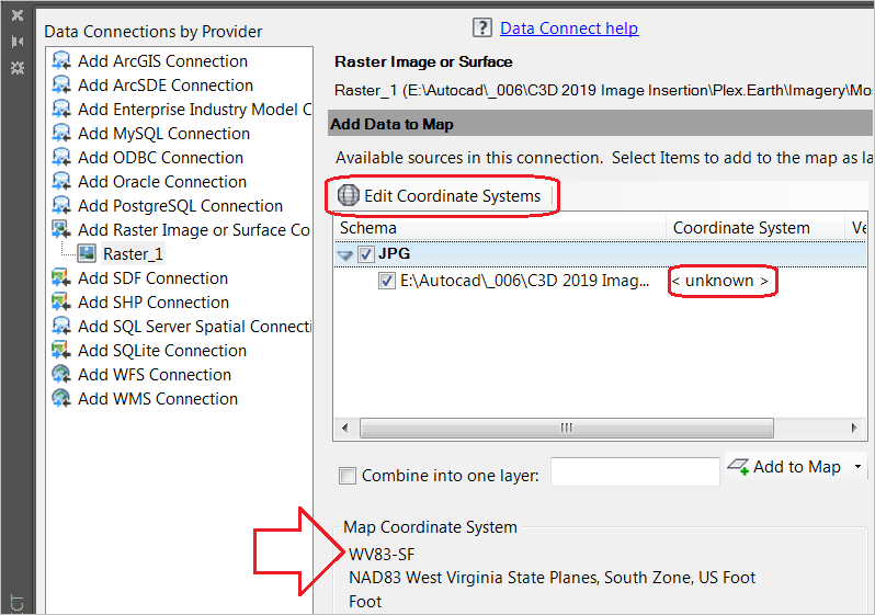

Your image shows <unknown> under the Coordinate System column in the Data Connect palette and you have not addressed this lack of geospatial reference. That is your issue.
Unknown Coordinates is not good. To  understand how to fix it, keeep reading.Unknown Coordinates is not good. To understand how to fix it, keeep reading.
You have chosen to ignore it and have pushed ahead with your workflow. The geospatial reference is a mainstay of the Data Connect palette because it allows you to position feature objects accurately against a 'known coordinate system.'
Imagine that modelspace is planet Earth and when you assign a particular CS to that modelspace you are making it representative of a 'defined portion of the planet.' Your assigned CS defines that portion using datum, projection, rotation and scaling. Assigning a CS is both easy and hard. All you have to do is pick the correct one from the CS Library. Simply pick the right one by clicking your mouse and you're done. Easy. The hard part is choosing the right one. Having no CS at all is a no-no.
The CS assigned to modelspace is totally independent to the CS assigned to your image. Your image must know where to go when referenced against your modelspace or planet Earth. If your image doesn't have the correct CS assigned to it, then it won't be positioned accurately in model. Also, leaving it as <unknown> will cause AutoCad to use default coordinates--which you already know can produce unfavorable results.
As long as AutoCAD understands both modelspace CS and the raster's CS, you are good to go. They don't have to be the same, they just have to be understood (or 'known' and 'appropriate' for your defined area of Earth).
To make your image geospatially accurate, try this:
1-Data Connect palette, click Edit Coordinate Systems button. Note: CS assigned to model is WV83-SF and <unknown> is displayed as CS for the image.1-Data Connect palette, click Edit Coordinate Systems button. Note: CS assigned to model is WV83-SF and <unknown> is displayed as CS for the image.2-Highlight DEFAULT then click EDIT.2-Highlight DEFAULT then click EDIT.3-In search box enter WV83 and  highlight WV83-SF (EPSG 26854), SELECT.3-In search box enter WV83 and highlight WV83-SF (EPSG 26854), SELECT.4-Back in Data Connect palette, WV83-SF has replaced <unknown>. Finally click ADD TO MAP.4-Back in Data Connect palette, WV83-SF has replaced <unknown>. Finally click ADD TO MAP.
Chicagolooper

When I do set coords under drawing settings to WV SPNAD 83 South Zone, US Foot and bring image in, the coords read:
x: 5585914.0463
y: 914320.9702
5585914.0463 / 1702590.0065 = 3.2808333333

When I do set coords in drawing settings and data connected to image and insert it, the coords and scale of image is wrong, but when I edit coordinate system and override to WV83-SF, the image re-projects itself correctly and is scaled correctly.
So is the image actually in UTM despite what the tfw and prj says? I will try and post a ftp link of the files.
