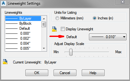

AllenJessup
I've never done it that way. But the only thing I can think of is to check the Default Lineweight.
