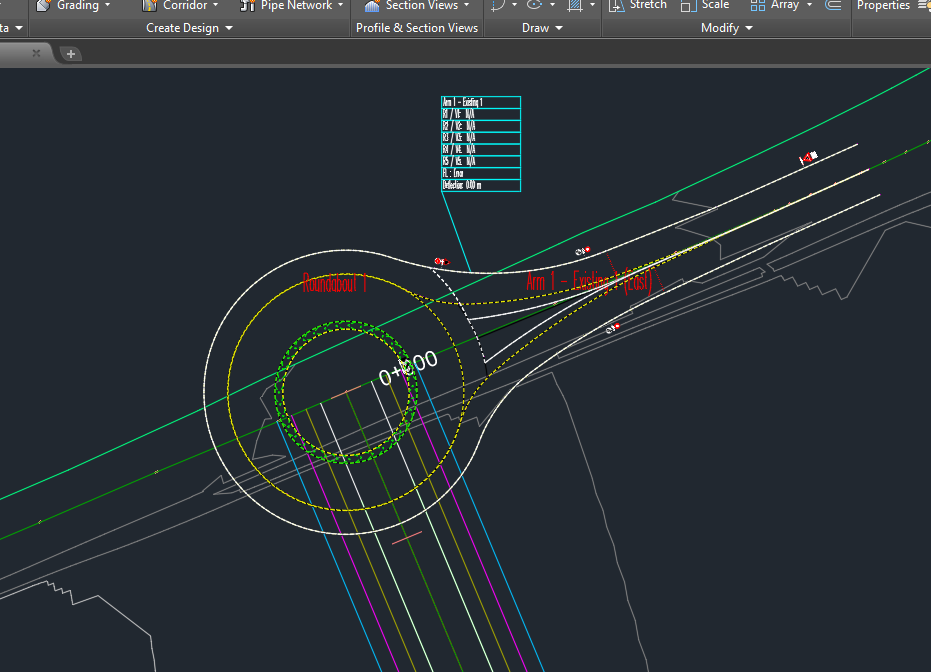

I'm trying to design roundabouts using the british junction design standards provided by Civil 3D. However, the roundabout produced has right-hand drive markings. Does anyone know how to change this?Capture.PNG

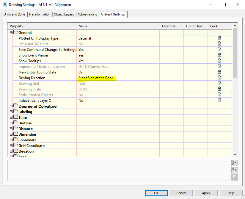

Want to mention to change the driving direction in the drawing ambient settings as well
hope that helps
