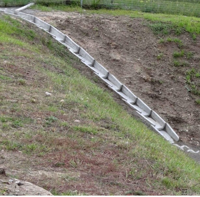

Hi everybody
Need to recreate a slope drainage in civil3D
is like a corridor made from individual elements
At the beggining I thought of creating an element in the subassembly composer, and use it in a feature line but it I could only create the front view of the element. and it wont representate the picture adobe. Do you have any ideas on how to make it?

that's a lot of detail, could you do an alignment down the middle of the drainage, showing the stepping of the profile and a basic U-shaped corridor of the inside dimensions targeting the existing on the outside edges. You would have a long section and you could cut some cross sections from that, you could possibly edit the widths within corridor section editor after for the narrowing and widening of the units if really needed,
dsacotokaczmarek
I fixed this by aligning a 3dblock in a path and making a path array is a lot of work but the only solution I came. Thanks @wol000 for the idea. I tried your idea but playing with the profile was more dificult than the one I finally went though.
