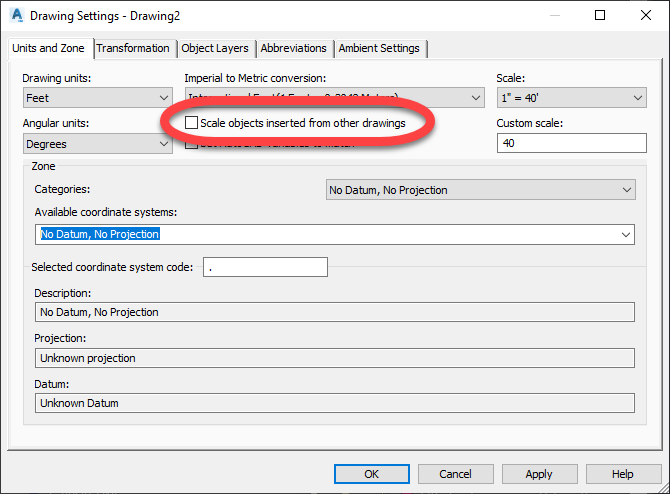

We have four drawings, one base and three xrefs. All four of them have the same settings for INSUNITS (2), and for AECDWGUNITSSETUP, as shown below.
Despite this, when we go to attach one of the xrefs, it insists on scaling the xref by 0.83333, as shown. There is nothing involved here that is defined in inches, all of these drawings are in feet. The only oddity is that the 3 xrefs were exported from ArcMap.
What other setting is controlling this?

dgladfelter
What about your Civil 3D Drawing Settings?

rkmcswain
Apologies @dgladfelter - forgot to mention those are all the same, just as in your screenshot.

I think we have a answer.
The child drawings I have were created with ESRI Arcmap. If I open the drawing, type in INSUNITS, and press enter , it says:
Command: INSUNITS
Enter new value for INSUNITS <2>:
So we can presume that INSUNITS cannot be blank, in other words, it must contain a value, right? We can also presume that the value reported to the user is the current value of the system variable. So based on that, you would agree that INSUNITS = 2 in this drawing.
So I close this drawing.
Then I reopen it, and do nothing except run the QSAVE command.
Then I Xref that newly saved version and the scale factor = 1.0, just like it should be.
So there is something about these .DWG files saved by ArcMap that AutoCAD doesn't understand, because it *looks* like INSUNITS = 2, but it does not behave like it until I resave the DWG file.
