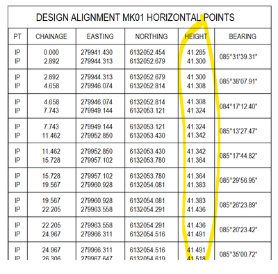

Hi, When creating an Alignment Table, is there a way to include the Height Data also as per the attached image?
I have been able to reproduce the rest of the data in a format that closely replicates that of a competitor's software package 🙂 but have not been able to find a way to include the Height Data which we have had to add manually instead.

Use customized pipe network structures at the points and a structure table with the data you wish

Thanks @Joe-Bouza. Would this work for Curves also?

Yikes! You could try using curved pipe and see what you can extract.
I think it may work but a separate table may be needed
