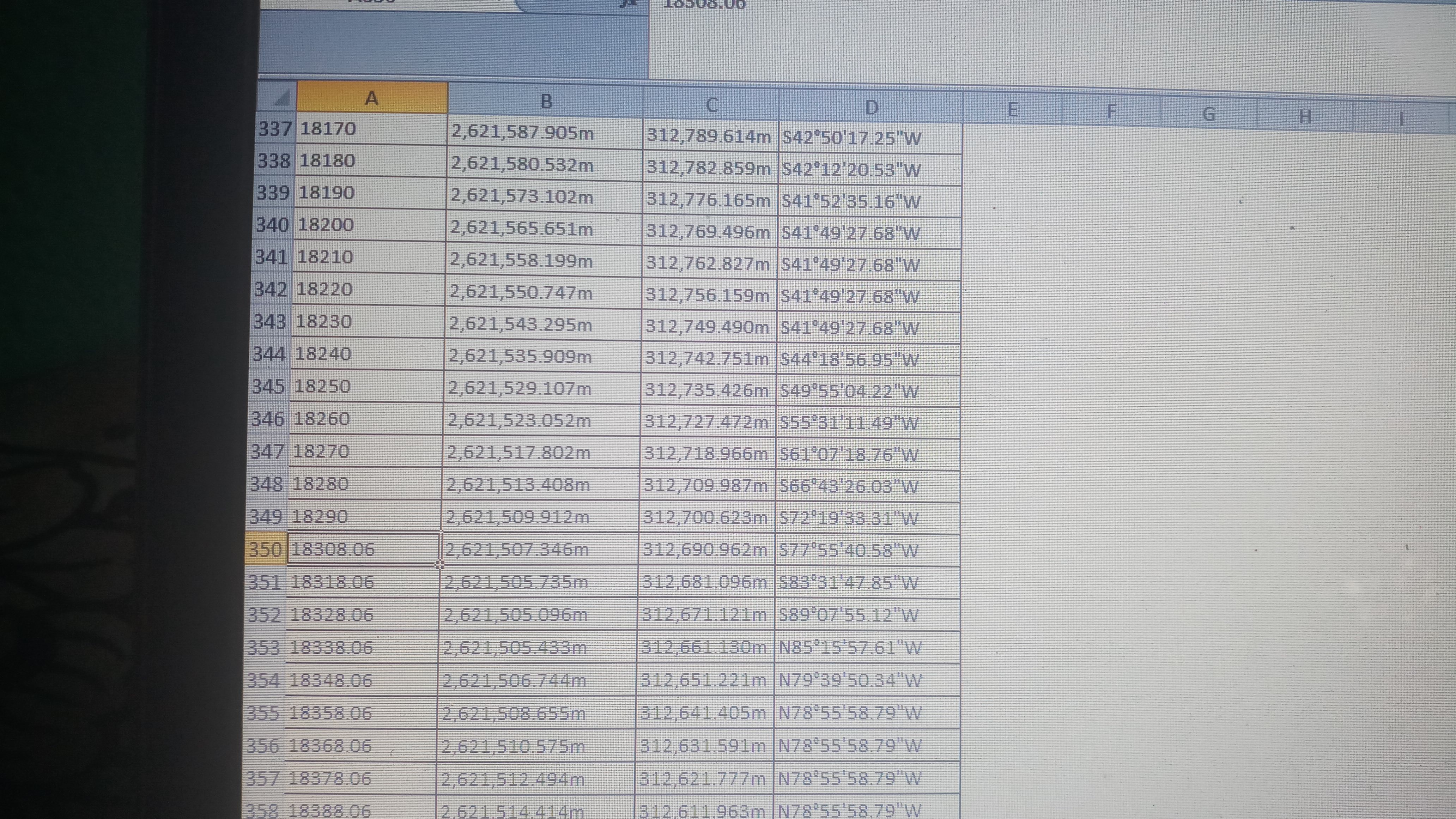

mgebeyehu1221
Community Visitor
Community Visitor
I just solved this issue check the attached image
