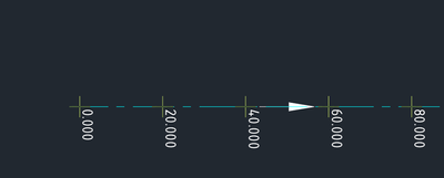

Hallo all the smart people here,
So I made new Major station label style with blocks that follows alignment and at a right distances. But I can't figure out how to get them to follow the alignment hight also. So Block's have to follow curve of alignment so to have right Z heights. Any ideas? All block's are one zero elevation.

Alignments or Alignment Labels/Blocks are Horizontal Only. They will always be 0

How can I make blocks follow the polyline in correct Z heights?
brian.strandberg
Easiest I can think of would be to create a simple corridor, and extract the corridor feature lines from the corridor at the centerline.  That is going to follow the entire length, not just at your interval stations.

The only way I can think of is to create point along the line based on the surface. You could use the block as your point style.
