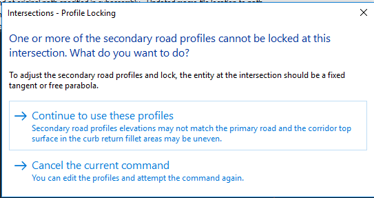

Hi Lads,
I create an intersection in civil 3d 2019, My problem is that the secondary road profile cannot be locked up and this message is popping up to suggest a solution but as I am novice to Civil 3D, I did not have a clue to solve this problem so if any one can suggest solution for this.

Curb return at Zero ElevationCurb return at Zero ElevationThis the message popping upThis the message popping up
hello,
There is a problem with the construction of the profile line. To lock it, the entity at the intersection should be a fixed tangent or a free parabola. otherwise he can't lock this line.
