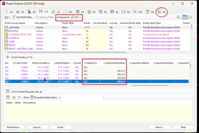

brian.strandberg
You can definitely do that.  Project Explorer gives you a ton of flexibility, BUT I hate that now I have two workflows for creating tables.
You can take this data from project explorer and create a custom table with the object sets tab (circled).

Message 5 of 12
Joe-Bouza
That's cool. Ill give it some effort now. Two work flows is a drag. are they civil3d tables or acad tables?
Joe Bouza
Message 6 of 12
brian.strandberg
There are a bunch of options in the object sets, autocad table, export to csv, excel, and it will auto-update if you tell it to.  Its nice, but I don't like to have to train on two workflows.  It would be great if they picked one and migrated the other over.

Message 8 of 12
Cadguru42
Project Explorer creates AutoCAD tables that have C3D data in them. However, they aren't truly dynamic as any manual ACAD changes done to it will be undone when the table is refreshed with C3D object data. They're semi-dynamic and Autodesk believes this is good enough.
But in this case I believe Project Explorer would be the best method to get a point to reference a depth.

Message 9 of 12
tcorey
Can you get Project Explorer to add the depth as a UDP? If you do that, the value will be available to regular Civil 3D labeling and tabling commands. I know this can be done with LISP. Maybe Dynamo.

Cadguru42
I don't know if it can. As far as I know PE just creates ACAD tables with C3D object data. You can create a table with COGO point data and also add alignment data to the same table. What can be linked between the various C3D objects is usually spatial. I.e., the COGO point will show the closest alignment station and offset. I don't know if PE can read UDP data in the first place, but I don't think it can transpose data from one object to another. I don't use it regularly, so maybe it can.
