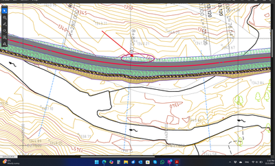

several Weeks ago, my college had the problem with 2025 when he was printing, there were the same artifacts for the non .shx fonts but not for all the annotations with the same fonts, only some of them. now I have the problem with this hatch it must be solid green hatch but...... I tried a lot of match properties from another hatch, change color everything I also rehatch the object what must have done I think, after I tried to print from another computer Civil 2023 installed and it works as it must be so what to do, I also replaced PDF24 with Adobe PDF but no way out What to do? I donot know how to avoid this pattern in 2025 sometimes it comes during printing sometimes not, does anyone has a solution?

is it possible that the hatch pattern is not set to solid, but because it is so dense it displays as solid, and what you are seeing is a scale differential?  It is hard to tell what is going on from the screenshot. What do you have HPMAXLINES set to?  Have you tried using AUDIT on your files to see if there is any corruption?  When you open the files, does it show any missing shx or font substitutions on the command line?

I tried everything probably bag in 2025 I do not know

Now it happens for leaders
