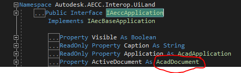

hippe013
This is just a shot in the dark here, but try:
Dim g_oDocument As AeccDocument
Set g_oDocument = g_oCivilApp.ActiveDocument
Otherwise it appears that it is returning an AcadDocument
https://knowledge.autodesk.com/support/civil-3d/learn-explore/caas/CloudHelp/cloudhelp/2017/ENU/Civi...
Hope that this helps.
